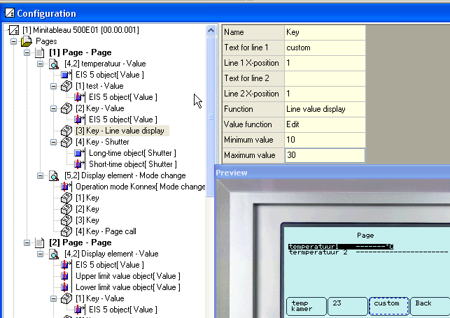

ik heb het eens bekeken in mijn systeem. ik vind die MT701 wel ingewikkeld hoor. Maar dit vond ik toch:
· Changing values
Depending on the configuration, you can change the corresponding display value ((EIS5, EIS6, EIS9, EIS10, EIS11 or EIS14) from an input window through the keys and send it to the bus, facility being given to specify the minimum and maximum values as well as the incrementation when setting up the configuration.
The "Value" key function only offers the possibility of sending a parameterised value. On the other hand, the "Line Value Display" key function offers the "Send" and "Edit" options for the "Value Function" parameter. If you select "Edit" you can specify limits between which changing the value will be allowed.
During the running time, a key with the parameterised "Line Value Display" key function and the "Edit" option will, if actuated, call a menu for changing the value shown by the display elements. The "Previous Value" display represents the current value, while the cursor will be blinking upon the selection of the "New Value" option and can thus be moved by the "<" and ">" arrow keys the to the digit of the value you want to influence. Use the right "Up" and "Down" arrow keys to increase or decrease the value, respectively. The "Enter" key will accept the new value and send it to the bus. By pressing the "Back" key you can trigger the return to the original page. If you have not accepted the new value with the "Enter" key and pressed the "Back" key the previous value will be retained.
How to change a limit value is described under "Limit Values".
't moet volgens mij dus wel kunnen, hoewel ik het niet kan uitproberen....
succes.
johan

- mt701.png (51.11 KiB) Viewed 9726 times
